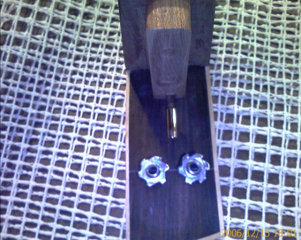

I really don't understand how strong the fretboard extension to the soundboard connection has to be. I thought I read here somewhere that someone dooesn't even bother to connect via bolts or glue. I thought of using these inserts and superglue them to my fretboard. I tried a test piece and they held pretty well. This was quite easy, glue them down, put the neck on, mark where they hit the soundboard and drill. Am I not providing enough structural integrity? Clinton

Unless you have planned for this type of attachment (block under the extension area) I wouldn't use any type of mechanical fasteners. They'll just rip out the soft spruce. Just glue it down. The joint isn't really that critical as you are really only trying to prevent buzzing of the extension.

I should of noted, I used a neck block extension. I'm not sure if that's what you call it. It's 1/2" thick, runs back to my upper brace, right above the sound hole. The inserts are 1/4" tall. So I was able to use 3/4" screws and washers. I've seen where they use a block of wood glued to the fretboard, but I got to wondering if this would suffice? Clinton

No don't do it that way. Like Paul said, youl will end up in a mess. Even with a block extention, you probably want a sled (term used in old shop)on the tongue to hold all of it down. Sand the area flat and glue.

It will probably work with super glue but it is mostly the glue that is doing the work as the 'T-nuts' are really in reverse to how they were designed. Threaded inserts would be a better choice for sure but what you have will probably do the trick. Now, having said this I am speaking from experience with these fastners and not this operation!

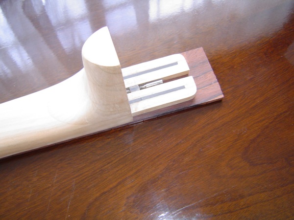

Here is a short explanation on how I make the bolt on section for the fingerboard extension.
First thing to do is have the neck properly aligned with the body.
Next, cut out the mortise and attach a block under the fingerboard extension.
This block supports the extension and adds thickness for the threaded inserts.
The #8-32 socket head cap screws (SHCS) and brass threaded insert are shown in the pocket for truss rod access.
Next step is to drill holes through the fretboard and support black at a fret slot.
I used the 18th fret.
This small hole will be completely covered with fret wire.
Remove the neck. Now you have perfectly aligned holes. Enlarge the holes in the guitar to accept the #8-32 SHCS.
Enlarge the holes in the fretboard extension block to accept the #8-32 brass inserts.
Use a brad point drill. Do not brill through the fretboard!
Screw in the brass threaded inserts and the job is done.
How's that?

I've been gluing my fingerboards to neck extensions for some years now, I never liked gluing my neck to the top if it could be avoided. But I think some of the advantages are lost if the FB is not glued to an extension of the neck itself rather than just to an additional block glued to the FB. My neck extensions are a continuation of the neck piece so that the FB is glued to the same piece of wood all the way along.
In the past I have always used threaded inserts into the extension and bolted it down to the neck block extension. However, Dave White an OLF member and a UK luthier who I respect enormously uses a similar system without bolting it down. So I'll be giving that a try this time.

   I can tell you that this will not work. Those are T nuts and they are not designed to be on the pull like you have them. They are designed to be used so that the threads will pull the teeth into the wood.
   Look at the design and you can see the teeth . As the wood dries they will come out.
   john hall

Steve, I really appreciate the tip. That's pretty nefty on how you mark the holes. From now on, no fretting until the FB extension is complete.
I guess my idea isn't very wise after reading your comments and re-evaluating.
